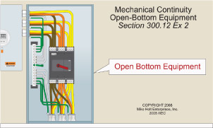

    2. Raceways that enter the bottom of open-bottom equipment, such as switchboards, are not required to be mechanically continuous to that equipment [300.12 Ex 2], as shown in Fig. 1.
