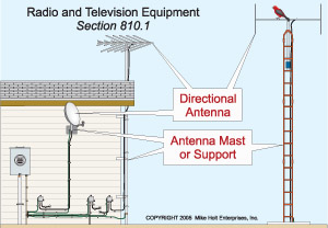

Article 810 provides installation requirements for transmitter and receiver equipment as well as the associated wiring and cabling (Fig. 1). Article 810 applies to: VHF/UHF antennas, which receive local television signals. Satellite antennas, also called satellite dishes. Roof-mounted antennas for AM/FM/XM radio reception. Amateur radio transmitting and receiving equipment, including HAM radio equipment
  • VHF/UHF antennas, which receive local television signals.
  • Satellite antennas, also called satellite dishes.
  • Roof-mounted antennas for AM/FM/XM radio reception.
  • Amateur radio transmitting and receiving equipment, including HAM radio equipment (a noncommercial communications system).
Requirements for all antenna systems. The first three kinds of installations in the bulleted list above involve receiving signals. The fourth also involves transmitting, which is why amateur radio installations have additional requirements over those for receiving antenna systems installations — we'll address those last.

Outdoor antennas and lead-in conductors must be securely supported, and the lead-in conductors must be securely attached to the antenna [810.12]. Don't attach outdoor antennas to the electric service mast [230.28]. Keep outdoor antennas and lead-in conductors at least 2 feet from exposed electric power conductors, to avoid the possibility of accidental contact [810.13].
Ground outdoor masts (and metal structures that support antennas) in accordance with 810.21 [810.15]. If an antenna mast is within 5 feet of a swimming pool, bond it to the equipotential bonding grid of the pool [680.26(B)(5)].
