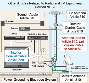

Keep in mind that Art. 810 addresses only those issues specific to this kind of equipment. You still must supply power per the requirements of Chapters 1 through 4. Wiring for audio signal processing, amplification, and reproduction equipment must comply with Art. 640. If you use coaxial cables to connect antennas to equipment, you must comply with Art. 820 (Fig. 1).
The wiring for a community television antenna must comply with this article, and the distribution coaxial wiring must comply with Art. 820. Don't confuse a community television antenna (Art. 810) with community antenna television (CATV) [Art. 820]. A community TV antenna can be used for multiple units in apartments, condominiums, motels, or hotels. On the other hand, CATV is utility-supplied cable TV.
