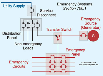

Power sources. An emergency system power source must have adequate capacity to safely carry all emergency loads expected to operate simultaneously [700.5]. If an alternate power source has adequate capacity, you can use it to supply emergency loads [Art. 700], legally required standby loads [Art. 701], and optional standby system loads [Art. 702]. But if the alternate power source lacks adequate capacity to carry the entire load, it must have automatic selective load pickup and load shedding to ensure adequate power — in this order of priority:
  • Emergency circuits
  • Legally required standby circuits
  • Optional standby circuits.
A temporary alternate source of power must be available whenever the emergency generator is out of service for more than a few hours [700.5(B)]. Transfer equipment must be automatic, identified for emergency use, and approved by the AHJ [700.6]. Transfer equipment must supply only emergency loads (Fig. 2 below). You must use multiple transfer switches where a single generator supplies emergency loads and other loads.

Separate service. You can use an additional service as the emergency power source, if it's installed per Art. 230 and is acceptable to the AHJ. Tapping ahead of the normal service equipment doesn't qualify as the required emergency source of power (Fig. 3 above). To minimize the possibility of simultaneous interruption of emergency supply, the additional service must be:
  • Served by a separate service drop or lateral.
  • Electrically and physically separated from all other service conductors.
