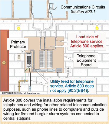

The point of demarcation between the telephone company and premise phone wiring is the primary protector unit (Fig. 1 at right). Everything on the facility side of that point is the responsibility of the installer and is bound by the requirements of Art. 800. Of course, the word “communications” no longer just applies to the telephone, so that article also applies to wiring for other communications purposes, including local area networks (LANs) and alarm systems connected to central stations.
Of the eight definitions in 800.2, “point of entrance” may be the most important — it applies to cable grounding (800.33) and determining the length of unlisted cable inside a building (800.50, Exception No. 3). This is where the cable emerges from an external wall or a concrete floor slab, or from a rigid metal conduit or intermediate metal conduit grounded to an electrode, per 800.40(B).

Protective devices.
Provide listed protective devices if your installation meets any of the conditions listed in 800.30(A). For example, if lightning is common in your area, be sure to install protective devices, per 110.3. You can use fuseless primary protectors under the conditions listed in 800.30(A)(1). Otherwise, you must provide fused primary protectors.
Locate fused primary protectors in, on, or immediately adjacent to the building being served and as close as you can to the point of entrance. Don't locate them in hazardous areas, except as permitted by 501.14, 502.14, and 503.12.
