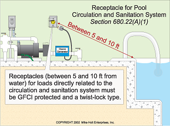

Receptacles for loads directly related to the circulation system that meet requirements listed in 680.22(A)(1) may be located not less than 5 ft from the inside wall. All other receptacles must be 10 ft from the water.
At a dwelling unit, you must install one 15A or 20A, 125V receptacle not less than 10 ft and not more than 20 ft from the water. This receptacle must be not more than 6.5 ft above the floor, platform, or grade level serving the body of water. That separation can be smaller in areas with restricted space (Fig. 2 at right). All receptacles must be GFCI-protected.
