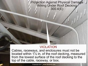

The rule in 300.4(E) regarding protection for raceways installed under metal-corrugated sheet roof decking has been expanded. The 2008 NEC introduced a requirement for the protection of most raceways when installed within 1½ in. of the underside of the roof deck. Although this 2008 rule change went a long way toward protecting wiring systems from damaging roofing screws that can penetrate the raceways, it left out one critical part of the installation — boxes. The 2011 revision corrects that and also clarifies that the measurement is to be made to the top of the cable, raceway, or box from the lowest surface of the roof decking (Fig. 1).
Fig. 1. A 2011 revision clarifies that the measurement is to be made to the top of the cable, raceway, or box from the lowest surface of roof decking.
This rule was also changed to prohibit wiring methods from being installed in concealed locations above the roof decking. In some instances, installers placed raceways above the roof deck prior to the insulation being installed. This resulted in the same potential for damage from roofing screws.
