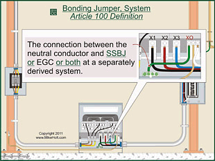

Bonding jumper, system
The connection between the neutral conductor and the supply-side bonding jumper (SSBJ) or equipment grounding conductor (or both) at a separately derived system (Fig. 1).
Fig. 1. Article 100 clearly defines the meaning of a system bonding jumper.

SIDEBAR: Why a System Bonding Jumper?
The system bonding jumper provides a low-impedance fault current path to the power supply to facilitate the clearing of a ground fault (by opening the circuit overcurrent device). For more information, see 250.4(A)(5), 250.28, and 250.30(A)(1).
