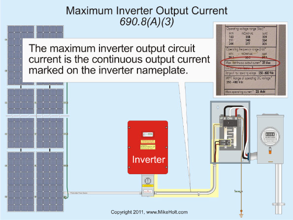

  • PV Source Circuit Current (Isc). Multiply the module nameplate short circuit current rating (Isc) by 125% [690.8(A)(1)].
  • PV Output Circuit Current. Add up the parallel PV Source Circuit Currents [690.8(A)(2)].
  • Inverter Output Circuit Current. According to 690.8(A)(3), this is equal to the continuous output current marked on the inverter nameplate (Fig. 1).
  • Stand-Alone Inverter Input Circuit Current. It’s the stand-alone continuous inverter rating when the inverter is producing power at the lowest rated voltage [690.8(A)(4)].
