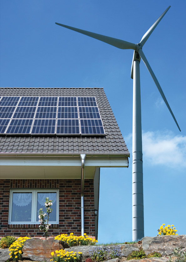

The 2011 NEC added Art. 694, which applies to small wind (turbine) electric systems that consist of one or more wind electric generators having a rated power up to and including 100kW (see Figure below). Typical system components are a generator (or alternator), inverter, and controller [694.1] — see SIDEBAR: Where the Wind Blows.
