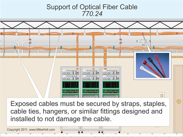

You must install equipment and cabling in a neat and workmanlike manner [770.24]. One of the implications of this is the routing of your cables cannot interfere with access to equipment [770.21]. For example, you must run them so they are not resting on top of ceiling tiles in a way that blocks access.
Ideally, you will run those cables with supports that fasten to frame members. But such an approach in a ceiling space is not always cost-effective or even possible. However, you must take this approach for exposed cables to ensure the cable will not be damaged by normal building use. Secure the cables with straps, staples, hangers, cable ties, or similar fittings designed and installed in a manner that won’t damage the cable (Fig. 1).
Fig. 1. Per the NEC, make sure you secure cables with straps, staples, hangers, cable ties, or similar fittings designed and installed in a manner that won’t cause damage to them.
You can support raceways and cables by independent support wires attached to the suspended ceiling per 300.11(A). Do not use the ceiling-support wires or ceiling grid directly [300.11]. In addition, do not strap, tape, or attach optical fiber cables (or any other kind of cable) to the exterior of any raceway as a means of support [770.133(D)].
