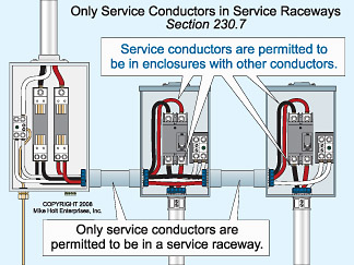

Service conductors must not pass through the interior of another structure [230.3]. Nor can you install them in the same raceway or cable with feeder or branch-circuit conductors [230.7].
This rule doesn't prohibit the mixing of service, feeder, and branch-circuit conductors in the same service equipment enclosure (Fig. 1).
