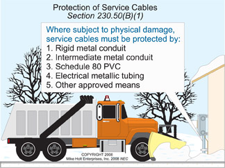

Protection from physical damage
Protect underground conductors from physical damage per 300.5 [230.50(A)]. For all other conductors, install in IMC, RMC, Schedule 80 PVC, or EMT (per Arts. 342, 344, 352, and 358, respectively) or use other means approved by the AHJ (Fig. 1).
Fig. 1. To protect conductors that are not underground from physical damage, follow the guidelines outlined above or consult the AHJ.
