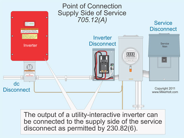

Fig. 1. You can connect an electrical power production source to the supply side of the service disconnecting means per 230.82(6).
Connecting
You can connect an electrical power production source to the supply side of the service disconnecting means per 230.82(6), as shown in Fig. 1. This connection is required for facilities incorporating ground fault protection of equipment [705.12(D)].
When determining the number of disconnects per service per 230.71(A), don’t count photovoltaic system (PVS) disconnect(s) connected on the supply side of service equipment. A PVS disconnect is not a service disconnect as defined in Art. 100. PVS Connections provides advice on photovoltaic power source connections.
You can connect the output of a utility-interactive inverter to the load side of the service disconnecting means at any distribution equipment on the premises [705.12(D)].
