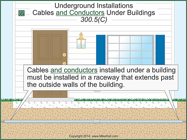

    The 2014 NEC expanded the rules for cables beneath buildings to include conductors beneath buildings [300.5(C)] (Fig. 1). It also increased the allowable types of underground raceways for the physical protection of direct-buried conductors and cables.
    Fig. 1. The 2014 NEC expanded the rules for cables placed beneath buildings.
    While some people use the terms “cable” and “conductor” interchangeably, the NEC does not. A cable (almost always) is an assembly of multiple conductors. Because direct-buried cables aren’t permitted under a building (generally), it makes sense that direct-buried conductors aren’t allowed either.
