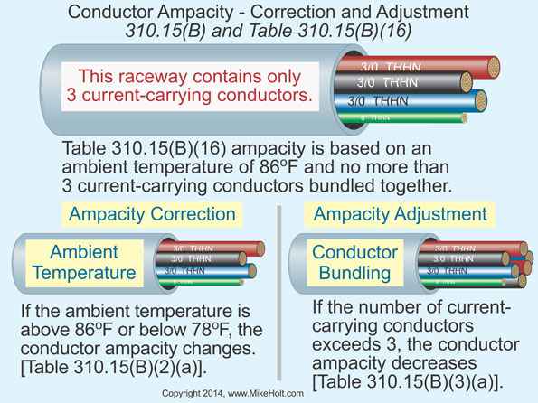

The ampacity of a conductor is the maximum current a conductor can carry continuously, under the conditions of use, without exceeding its temperature rating. Table 310.15(B)(16) lists conductor ampacities under the condition of no more than three current-carrying conductors bundled together in an ambient temperature of 86°F (30°C). The reason for “no more than three” is because when you go above that number each additional conductor diminishes the heat dissipation abilities of all conductors in the raceway.
Ampacity correction and adjustment
Ampacity correction (ambient temperature) [Table 310.15(B)(2)(a)] and adjustment (bundling) [Table 310.15(B)(3)(a)] factors are based on the ampacity rating of the conductor insulation per Table 310.15(B)(16) (Fig. 1).
Fig. 1. Ampacity correction and adjustment factors are based on the ampacity rating of the conductor insulation per Table 310.15(B)(16).
When determining conductor ampacity under the condition where the ambient temperature is not 86°F (30°C) or the raceway contains no more than three current-carrying conductors, we must use the ampacity listed in the 90°C column of Table 310.15(B)(16).
When conductors are installed in an ambient temperature other than 78°F to 86°F, you must use the multipliers listed in Table 310.15(B)(2)(a) to correct the ampacities listed in Table 310.15(B)(16).
The higher insulation temperature rating of 90°C rated conductors provides a greater conductor ampacity for use in ampacity correction and adjustment, even though you must size conductors based on the column that corresponds to the temperature listing of the terminals [110.14(C)(1)].
Fig. 2. When different ampacities apply, the higher ampacity is permitted for the entire circuit if the reduced ampacity length doesn’t exceed 10 ft or 10% of the length of the higher ampacity, whichever is less.
Where more than one ampacity applies for a given circuit length, you must use the lowest ampacity value [310.15(A)(2)]. But you can use a higher ampacity for the entire circuit if the reduced ampacity length doesn’t exceed 10 ft or 10% of the length of the higher ampacity (whichever is less) [310.15.(A)(2) Ex] (Fig. 2). Here’s the ambient temperature correction formula:
Corrected Ampacity = (Table 310.15(B)(16) Ampacity) × (Ambient Temperature Correction Factor [Table 310.15(B)(2)(a)])

Bundling adjustments. Bundling more than three conductors in the same raceway degrades the ability of each conductor to dissipate heat, requiring you to adjust the ampacity downward, accordingly.
Here’s the conductor bundling adjustment formula:
Adjusted Ampacity = (Table 310.15(B)(16) Ampacity) × (Bundling Adjustment Factor [Table 310.15(B)(3)(a)])
