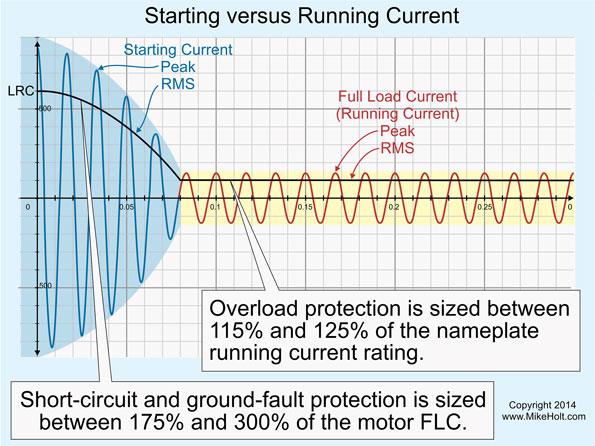

When motors start across the line, they typically draw five times the running current. This temporary “inrush” is an overload condition. To handle inrush while still providing adequate overcurrent protection, we divide overcurrent protection into two parts (Fig. 1):
1. Short circuit and ground fault protection. Typically, this is via a fuse or circuit breaker sized large enough to let the motor start. But if it’s large enough to let the motor start, it’s too large to provide overload protection.
2. Overload protection. This protects the motor and wiring at a value close to the actual running current of the motor, but with sufficient time delay to allow the motor to start.
Fig. 1. Starting current can be five times higher than running current.
