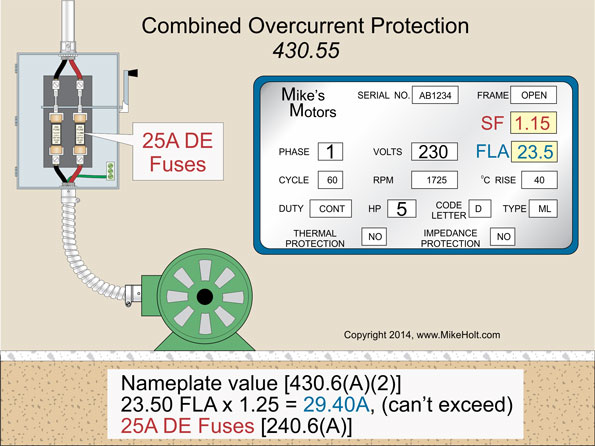

As noted earlier, for motor circuits, we separate the functions of overload protection from those of protection against short circuits and faults. But with short-time, intermittent, periodic, or varying-duty motors, you can combine these functions in the OCPD [430.33]. The catch here is the rating or setting of the OCPD can’t exceed the values in Table 430.52. And, of course, the controls or the nature of the application must ensure the motor can’t operate continuously under any conditions of use.
In many cases, the inrush isn’t enough to create the problems that require the separation of OCP and OCPD, even if you do have a continuous-duty motor. Then you can use a single OCPD to protect a motor against overload, short circuit, and ground faults. But you must size it to the overload requirements in Sec. 430.32 [430.55].
Here’s an example to help illustrate the concepts we’ve discussed thus far.
Fig. 1. In this combined overcurrent protection example, the rating or setting of the OCPD can’t exceed the values shown in Table 430.52.
Question: What size dual-element fuse is permitted to protect a 5-hp, 230V, single-phase motor with a service factor of 1.15 and a nameplate current rating of 23.50A from overloads and from short circuits and ground faults (Fig. 1)?
Size the overload protection per Sec. 430.32(A)(1) and Sec. 430.55.
23.50A × 1.25 = 29.40A
Based on the standard ampere ratings of fuses shown in Sec. 240.6(A), you should use a 25A fuse to protect the motor.
