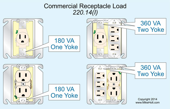

  • The load for a general-use receptacle outlet in a non-dwelling occupancy is 180VA per yoke [220.14(I)]. The maximum number of receptacle outlets permitted on a commercial or industrial circuit depends on the circuit rating. To calculate the number of receptacles per circuit, divide the VA rating of the circuit by 180VA for each receptacle yoke. Note that a duplex receptacle is two receptacles on the same yoke [100]. For this calculation, a single receptacle or a duplex receptacle each count as 180VA (Fig. 3).
Fig. 3. Each 15A or 20A, 125V general-use receptacle outlet is considered as 180VA per mounting yokes.
