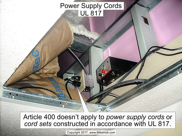

Article 400 covers the general requirements, applications, and construction specifications for flexible cords and cables. But Art. 400 doesn’t apply to “power supply cords” or “cord sets” constructed in accordance with UL 817 (Photo 1).
Photo 1. One place you might find power supply cords is in the space right above a drop down ceiling grid.

Article 400 requirements apply only to flexible cords [UL 62]. Power supply cords [UL 817] don’t fall within the scope of Art. 400, so you can run a power supply cord through a cabinet wall for an appliance (Fig. 2). You can also run a power supply cord through, or locate it above, a suspended ceiling.
