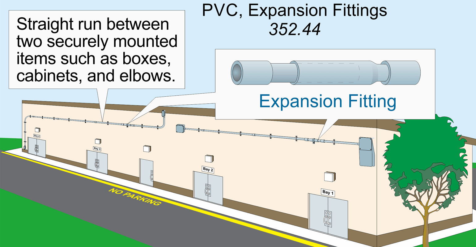

Expansion fittings
If installing PVC conduit in a straight run between securely mounted items (e.g., boxes) provide expansion fittings if the expansion or contraction length change (per Table 352.44) is expected to be ¼ in. or greater [352.44] (Fig. 3). When determining the number and setting of expansion fittings, read the manufacturer’s documentation.
