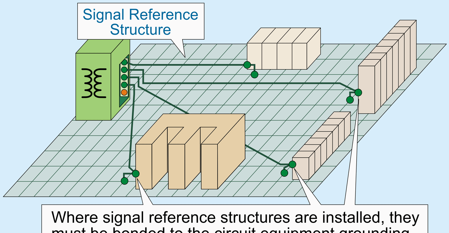

Grounding and bonding
Separately derived power systems used for IT equipment (power distribution units) must be grounded and bonded per Sec. 250.30 [645.14]. Exposed metal parts of an IT system must be connected to the circuit equipment grounding conductor (EGC) [Sec. 645.15].
Where signal reference structures are installed, they must be bonded to the circuit EGC provided for the IT equipment (Fig. 3).
If you install isolated ground receptacles, then you must connect them to an insulated EGC per Sec. 250.146(D) and Sec. 406.3(D).
