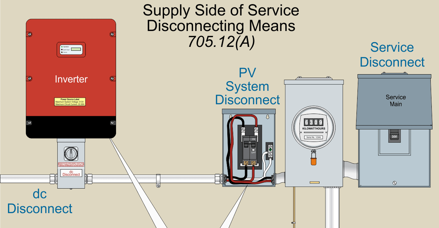

Supply-side connection
If you’re connecting the system interactive inverter output circuit conductors on the supply side, then you must meet two requirements [Sec. 705.12(A)]:
1. Comply with Sec. 230.82(6) (Fig. 1).
2. Ensure the sum of the ratings of all overcurrent protection devices (OCPDs) does not exceed the ampere rating of the electric utility service.
When determining the number of disconnects per service per Sec. 230.71(A), the PV disconnect(s) connected on the supply side of service equipment isn’t counted. That’s because it’s not a service disconnect as defined in Art. 100.
