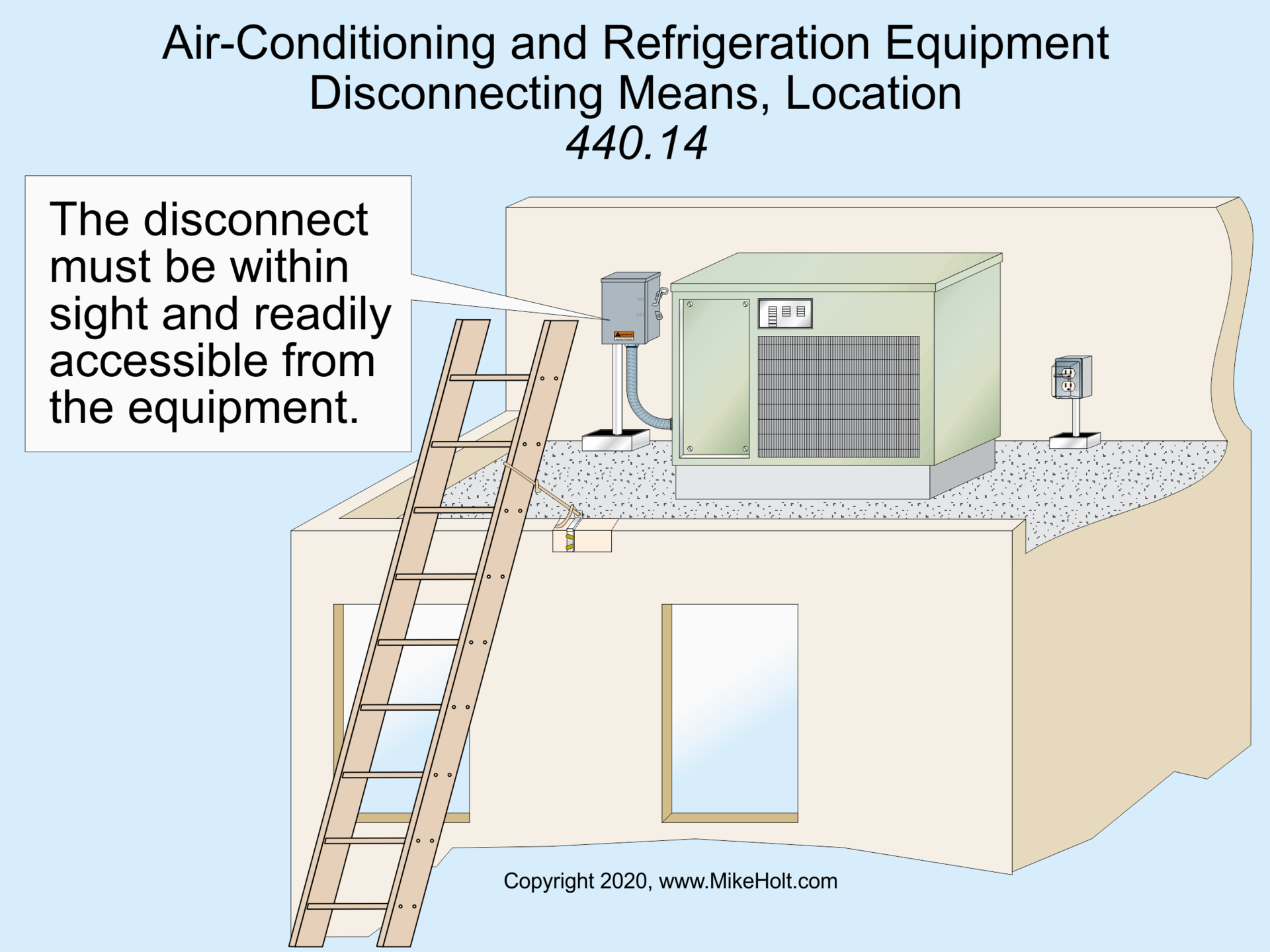

If you install A/C or refrigeration equipment on the roof and connect it with a metallic raceway that uses compression-type fittings, then you must install an equipment grounding conductor (EGC) of the wire type [Sec. 440.9].A disconnect for A/C or refrigeration equipment must be within sight from, and readily accessible from, the equipment [Sec. 440.14] (Fig. 3).
“Within sight” means it is visible and not more than 50 ft from the equipment [Art. 100].The disconnect can be mounted on or within the equipment, but it can’t be on panels designed to allow access to the equipment and can’t be over the equipment nameplate.
