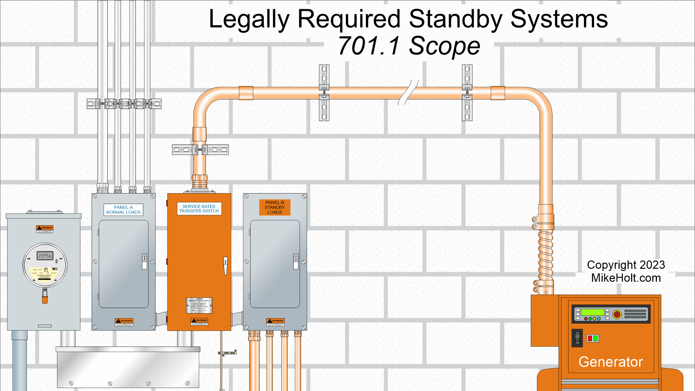

Article 701 covers the installation, operation, and maintenance of legally required standby systems consisting of circuits and equipment intended to supply illumination or power when the normal electrical supply is interrupted. The goal is to aid in firefighting, rescue operations, control of health hazards, and similar operations (Fig. 1).
Legally required standby systems typically supply loads, such as heating and refrigeration systems, ventilation and smoke removal systems, sewage disposal, lighting systems, and industrial processes that, when stopped, could create hazards or hamper rescue or firefighting operations [Sec. 701.1 Note 4].
