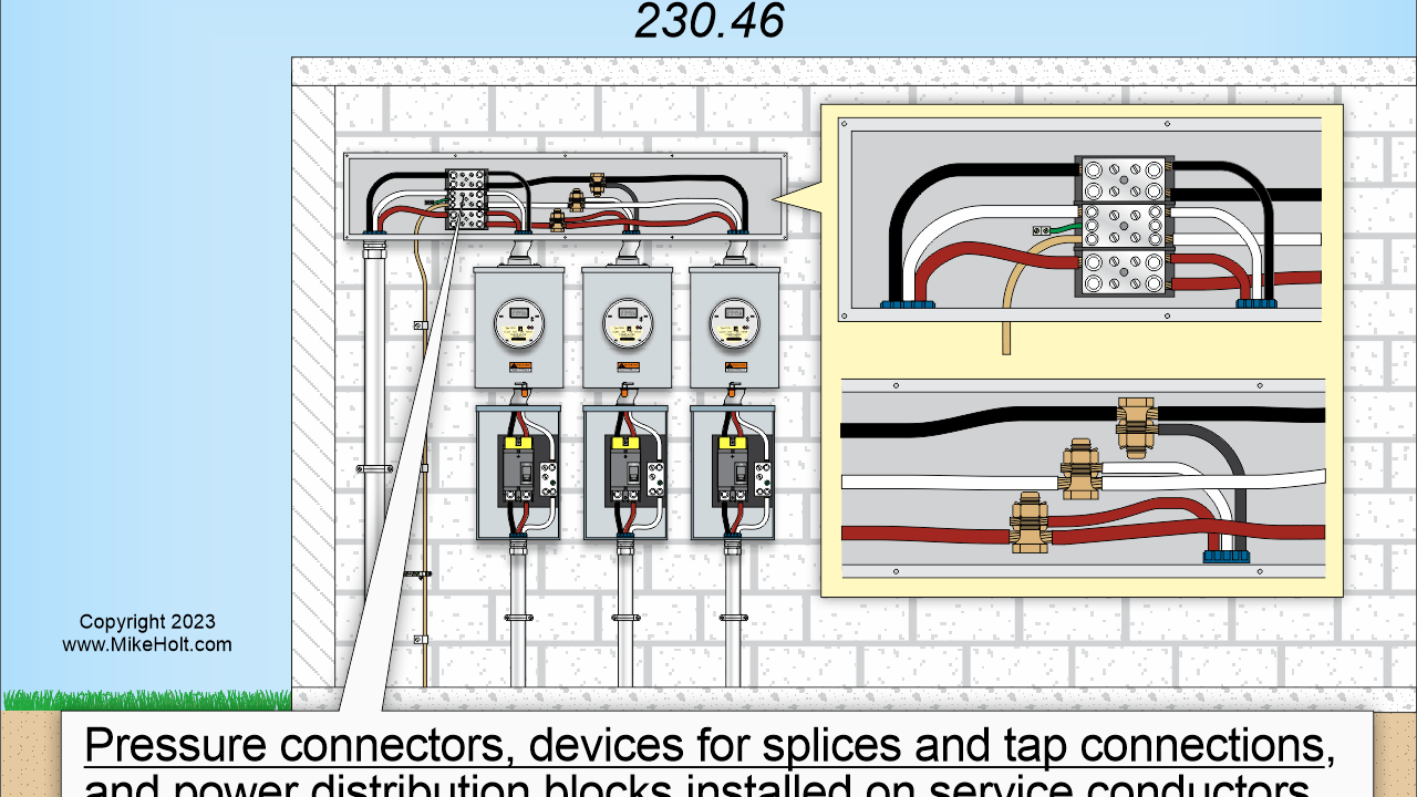

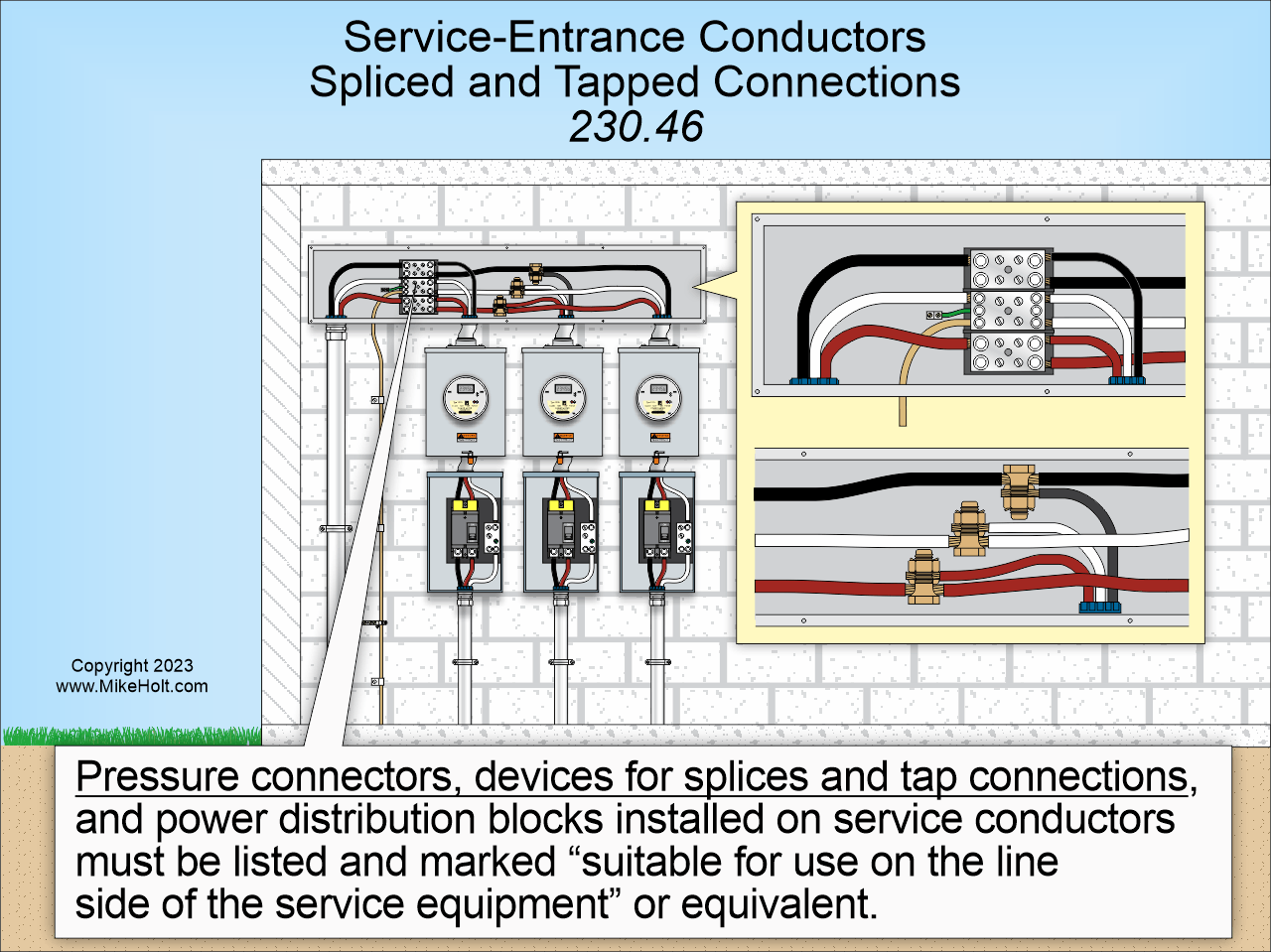

Pressure connectors, devices for splices and tap connections, and power distribution blocks installed on service conductors must be listed and marked “suitable for use on the line side of the service equipment” or equivalent [Sec. 230.46], as shown in Fig. 1.

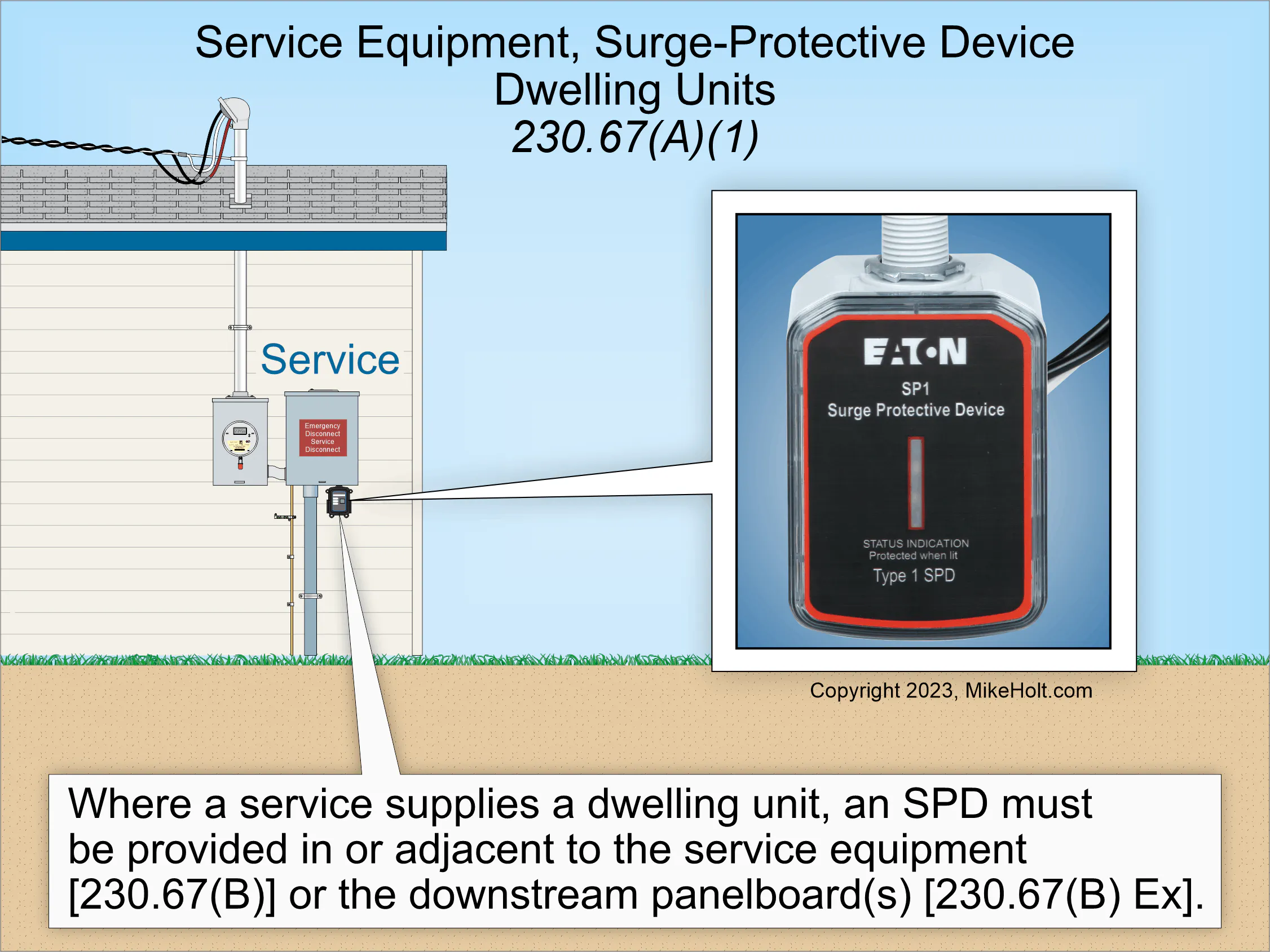

Surge protection
Where a service supplies any of the following occupancies, you must provide a surge-protective device [Sec. 230.67(A)]:
(1) Dwelling units (Fig. 2).
(2) Dormitory units.
(3) Guest rooms and guest suites of hotels and motels.
(4) Areas of nursing homes and limited care facilities used exclusively as patient sleeping rooms.
The surge-protective device must be a Type 1 or Type 2 SPD [Sec. 230.67(C)] and must be an integral part of the service disconnect or be immediately adjacent to the service disconnect [Sec. 230.67(B)]. Exception: The surge-protective device is permitted to be at the downstream panelboard.

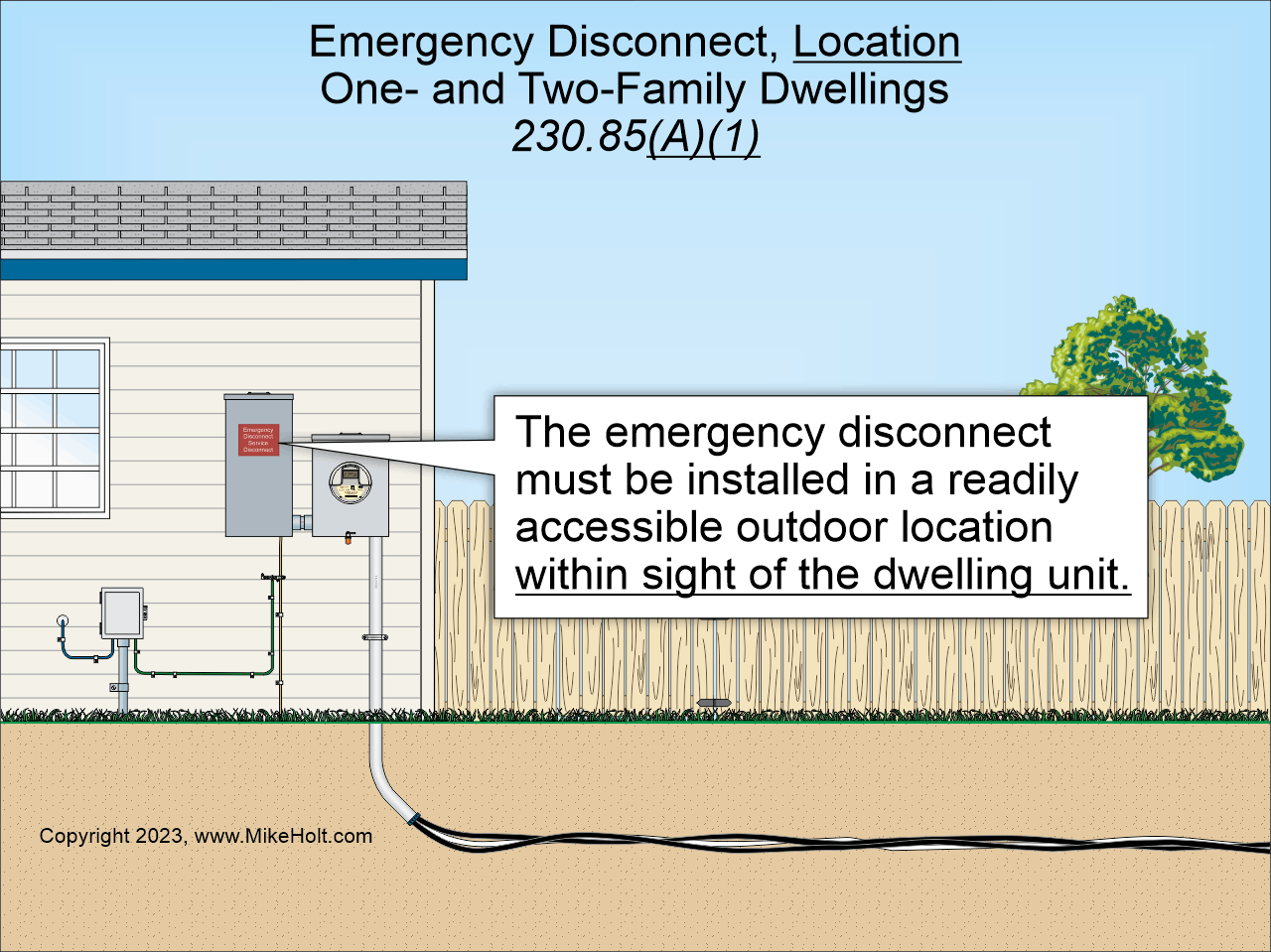

Emergency disconnect
For one- and two-family dwelling units, an emergency disconnect must be installed per Sec. 230.85(A) through (E).
(A) General. The requirements are about what you’d expect: readily accessible, within sight from the dwelling unit, has a short-circuit rating of at least that of the available fault current, and grouped if more than one disconnect (Fig. 3).
(B) Type. It has to be a service disconnect, integrated meter disconnect, or other listed switch or circuit breaker suitable for service equipment.
