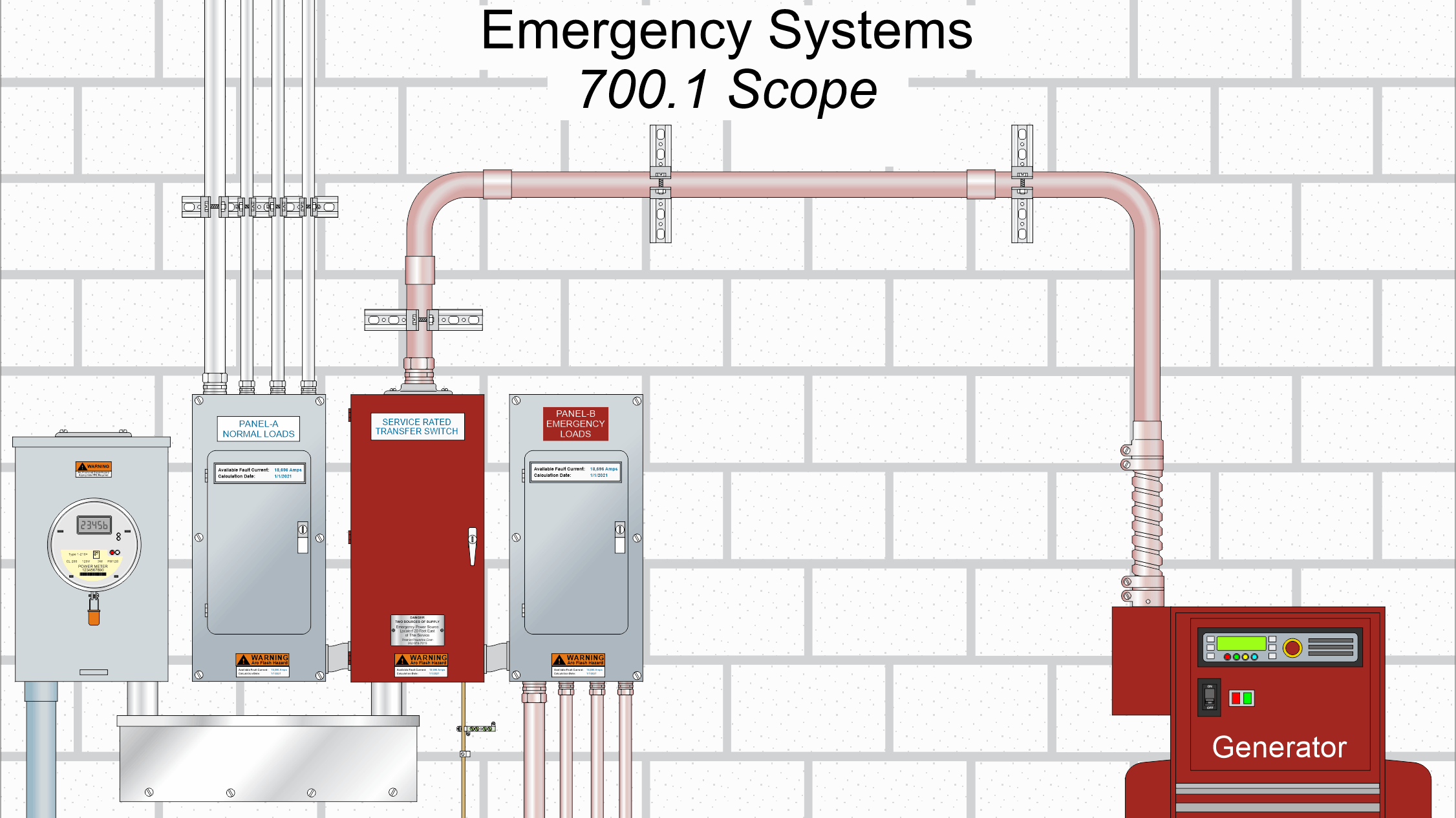

Emergency systems
Article 700 covers the installation, operation, and maintenance of emergency systems (Fig. 1).
An emergency system must have adequate capacity per Art. 220 or by another approved method [Sec. 700.4(A)].
The emergency system power source(s) can supply emergency, legally required system, and optional standby system loads, where a load management system includes automatic selective load pickup and load shedding to ensure adequate power to each system.
Audible, visual, and facility or network remote annunciation signaling devices must be installed where applicable for the purposes enumerated in Sec. 700.6(A) through (D). For example, to indicate the emergency source is carrying a load.
Emergency system conductors cannot be installed within any cabinet, enclosure, raceway, cable, or luminaire with nonemergency loads, except as noted in Sec. 710(B)(1) through (6). For example, wiring within a traveling cable to an elevator.
Line voltage supply wiring and Class 2 power-limited emergency lighting control devices must comply with Sec. 700.10. Class 2 power-limited emergency circuits must comply with Sec. 700.11(B) through (D). For example, exposed cable, cable tray, or raceway systems must be marked to be identified as a component of an emergency circuit or system within 3 ft of each connector and at intervals not to exceed 25 ft.
Emergency power must be available within 10 seconds upon failure of normal power. The emergency power supply must be one or more of the types described in Sec. 700.12(C) through (H). For example, a generator.
In selecting an emergency power source, consider the occupancy and the type of service to be rendered, whether of minimum duration, as for evacuation of a theater, or longer duration, as for supplying emergency power and lighting due to an indefinite period of current failure [Sec. 700.12(A)].
The emergency power source must be of suitable rating and capacity to supply and maintain the total load for the duration determined by the system design. In no case can the duration be less than 2 hours of system operation unless used for emergency illumination in Sec. 700.12(C)(4) or unit equipment in Sec. 700.12(I).
Emergency circuits must supply only emergency loads [Sec. 700.15]. Emergency illumination (egress lighting, illuminated exit signs, etc.), per Sec. 700.16(A), must be designed and installed so that the failure of any illumination source will not leave in total darkness any space requiring emergency illumination [Sec. 700.16(B)]. For any emergency system, emergency illumination is required for an indoor service disconnect [Sec. 700.16(D)].
