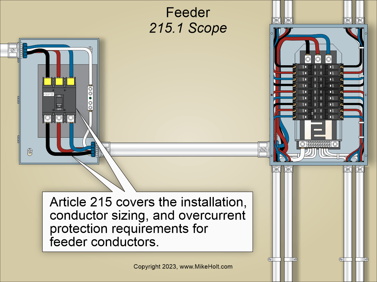

Article 215 covers the installation, conductor sizing, and overcurrent protection requirements for feeder conductors not over 1,000VAC or 1,500VDC (Fig. 1).
Feeders are the conductors between the service disconnect, a separately derived system, or other power supply, and the final branch-circuit OCPD [Art. 100].
