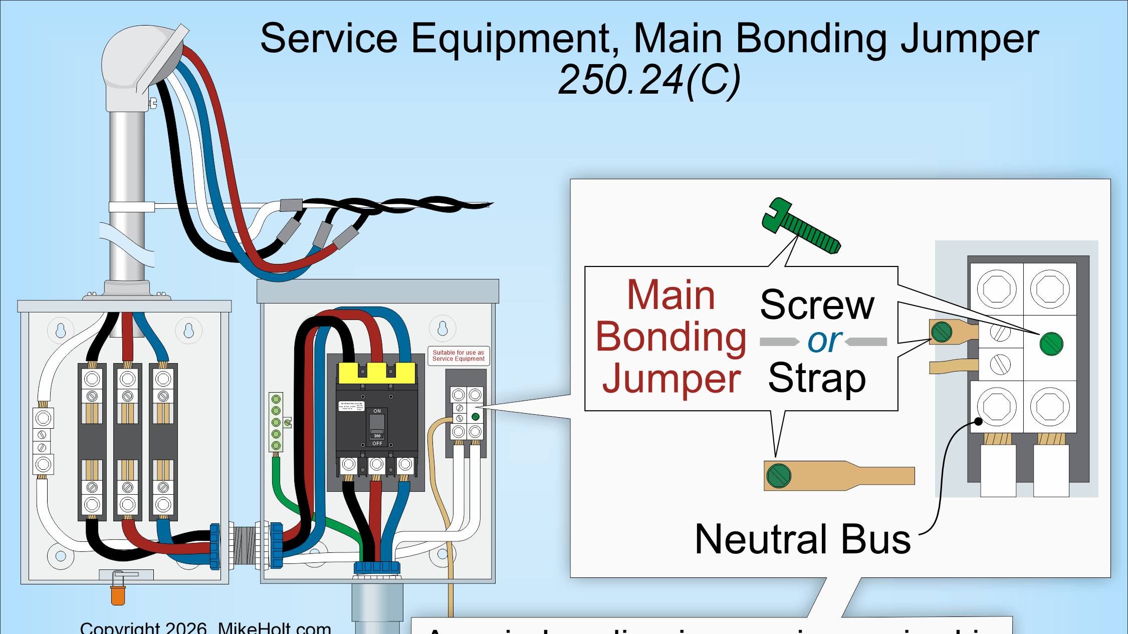

Main bonding jumper
A “main bonding jumper” is a wire, screw, or busbar used to connect the service neutral conductor to the EGC, supply-side bonding jumper, or both at the service disconnect enclosure [Art. 100].
The main bonding jumper is a vital component of bonding. It facilitates the operation of overcurrent protective devices and is a critical part of the grounding system, since it bonds the neutral conductor, service enclosure, and the EGC to the GEC via the grounding electrode conductor.
A main bonding jumper is required to bond the EGC to the neutral conductor in each service disconnect enclosure per Sec. 250.28 [Sec. 250.24(C)], as shown in Fig. 2.
