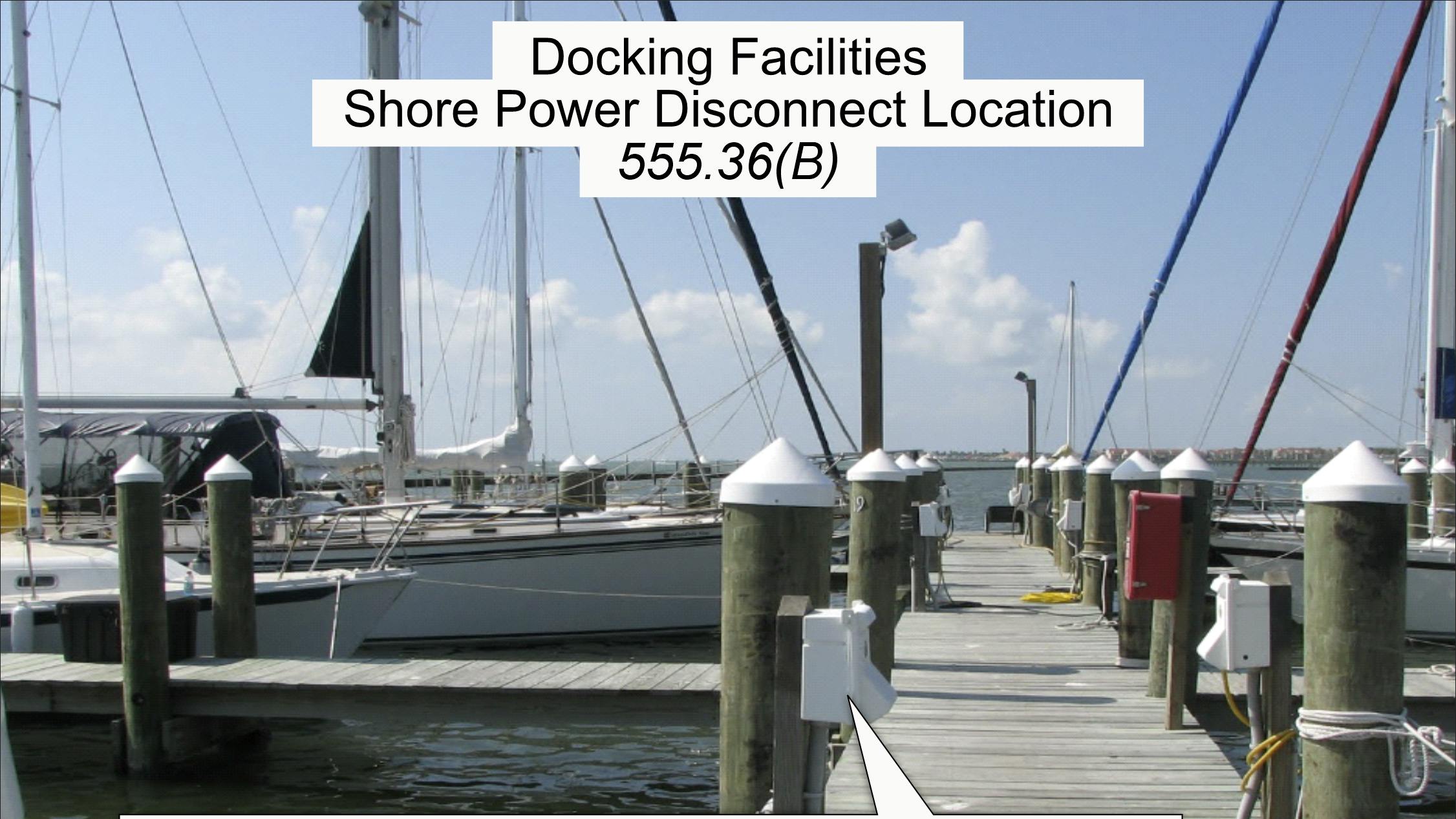

Disconnecting means
Provide a disconnecting means for each shore power receptacle. It must be a circuit breaker or switch that identifies the shore power receptacle it controls. It must be readily accessible and not more than 30 in. from the receptacle it controls [Sec. 555.36], as shown in Fig. 3.
Each marina power outlet or enclosure that provides shore power to boats must have a listed emergency shutoff device or disconnect that is marked “Emergency Shutoff” per Sec. 110.22(A) [Sec. 555.36(C)]. This disconnect provides a means to shut off power if a swimmer comes in contact with an energized metal boat, dock, or ladder and anytime it appears that ESD is occurring.
The emergency shutoff device or disconnect must be within sight of the marina power outlet, readily accessible, externally operable, and manually resettable. It must de-energize the power supply to all circuits supplied by the marina power outlet(s). You cannot use a circuit breaker handle for this purpose.
