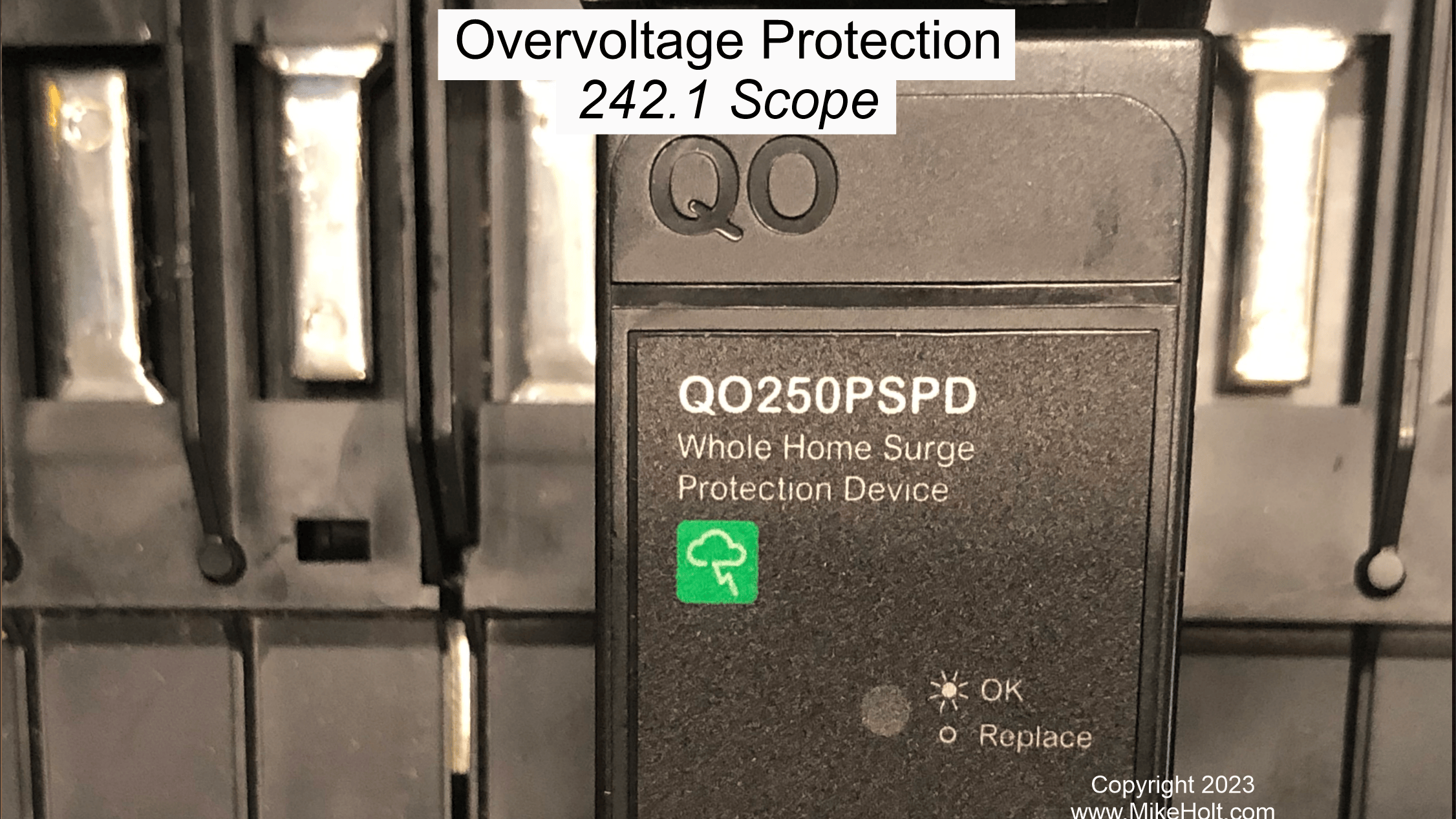

To protect against transient overvoltage, you need a surge protection device (SPD). An SPD limits transient overvoltages by diverting or limiting surge current and preventing its continued flow while remaining capable of repeating these functions [Art. 100]. Article 242 provides the general, installation, and connection requirements for overvoltage protection and SPDs (Fig. 1).

An SPD must indicate that it is functioning properly [Sec. 242.9], as shown in Fig. 2. When you install an SPD, ensure this indication is readily visible without needing to move aside conductors or to stand on one’s head to see it.
