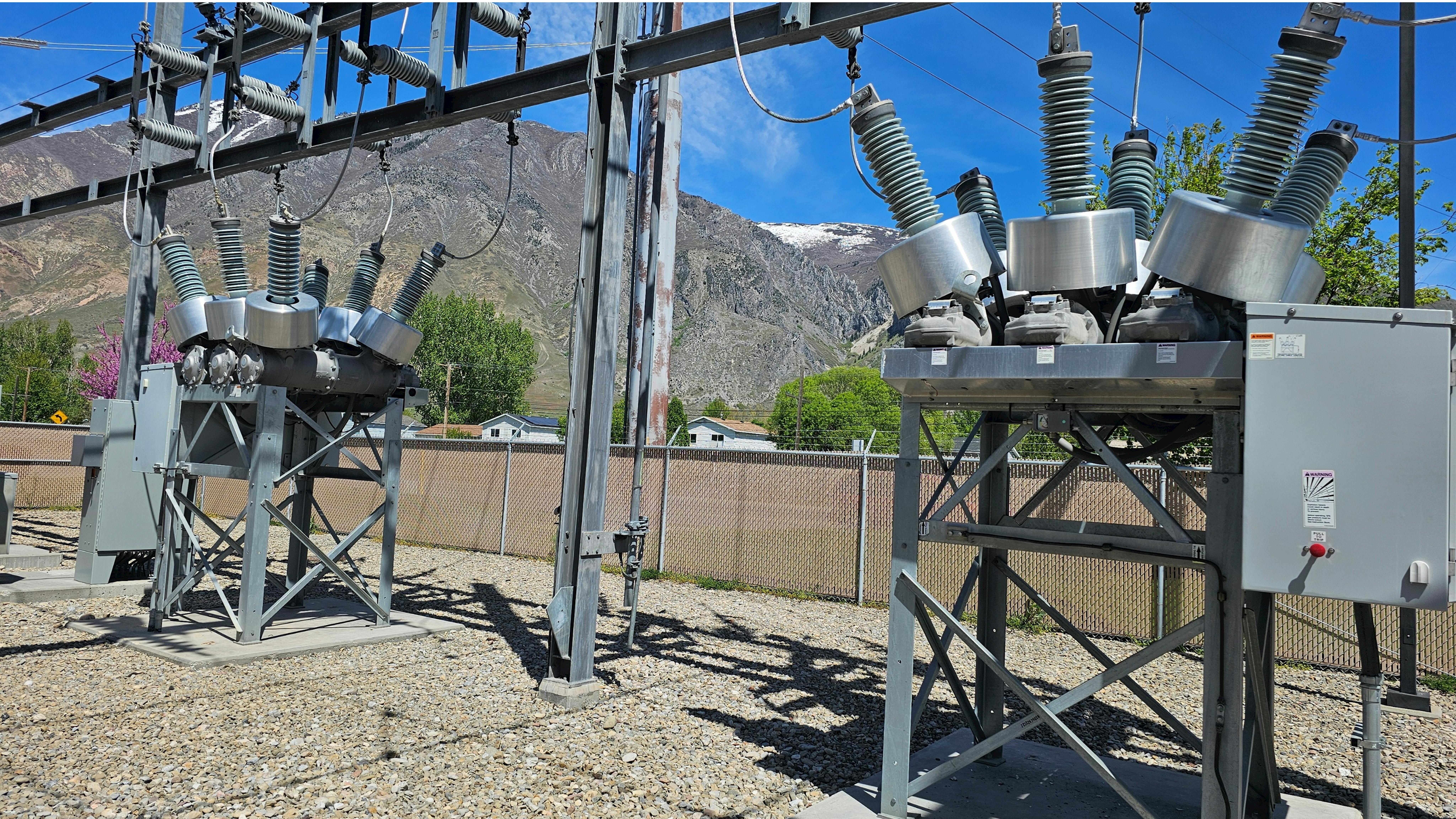

  • Articles 265 through 270 are now the home for the requirements for systems operating above 1,000VAC or 1,500VDC (sometimes called “medium voltage,” although that term is not defined). Most of this material was previously located in other Articles, including 235, 250, and 399 (Photo 2).
