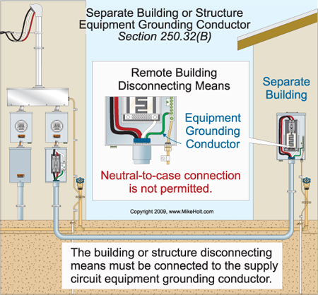

Q. Can we install a 3-wire feeder (no equipment ground) to a pool house and bond the neutral and ground at the new panel?
A. No. To quickly clear a ground fault and remove dangerous voltage from metal parts, the building or structure disconnecting means must be connected to the circuit equipment grounding conductor of a type described in 250.118. The supply circuit equipment grounding conductor must be sized in accordance with 250.122, based on the rating of the overcurrent device. [250.32(B)]
