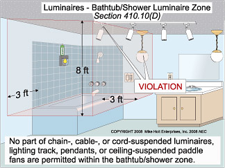

Q. What are the requirements for installing fixtures in a bathroom?
A. No part of chain-, cable-, or cord-suspended luminaires, track luminaires, or ceiling paddle fans can be located within 3 feet horizontally and 8 feet vertically from the top of the bathtub rim or shower stall threshold, as shown in Fig. 1.
Luminaires located within the actual outside dimensions of a bathtub or shower to a height of 8 feet from the top of the bathtub rim or shower threshold must be marked for damp locations. Where subject to shower spray, the luminaires must be marked for wet locations [410.10(D)], as shown in Fig. 2.
