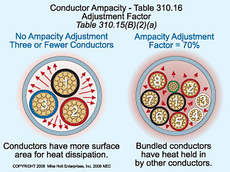

Step 3. Determine conductor ampacity after adjustment. The ampacity of a conductor is the current the conductors can carry continuously under specific conditions of use [Art. 100 definition]. Conductor ampacities are listed in Table 310.16 under the condition of no more than three current-carrying conductors bundled together in an ambient temperature of 86°F.
When conductors are bundled together, the ability of the conductors to dissipate heat is reduced. The NEC requires that the ampacity of a conductor be reduced in accordance with the adjustment factors listed in Table 310.15(B)(2)(a) whenever four or more current-carrying conductors are bundled together (Figure). The higher insulation temperature rating of 90°C rated conductors provides a greater conductor ampacity for use in ampacity adjustment, even though conductors must be sized based on the column that corresponds to the temperature listing of the terminals [110.14 (C)(1)].
The ampacity of 90°C 600kcmil conductors (Step 2) after an 80% adjustment factor [Table 310.15(B)(2)(a)] is 380A (420A × 0.80).
