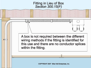

Is it legal to make a mechanical transition from electrical metallic tubing (EMT) to flexible metal conduit with a fitting that joins these two raceways instead of installing a box?
April 1, 2007
4 min read
All questions and answers are based on the 2005 NEC.
Q. Is it legal to make a mechanical transition from electrical metallic tubing (EMT) to flexible metal conduit with a fitting that joins these two raceways instead of installing a box?
A. Yes, if the fitting is identified for the use, and the conductors are not spliced or terminated within the fitting [300.15(F)]. Otherwise, a box is required (Figure).
