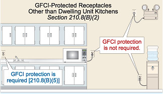

Q. Is GFCI protection required for receptacles above the counter of a break room in an office building?
A. If the break room has a sink and permanent provisions for food preparation and cooking [Art. 100 Kitchen], then all 125V, 15A, and 20A receptacles in the kitchen area must be GFCI protected [210.8(B)].
