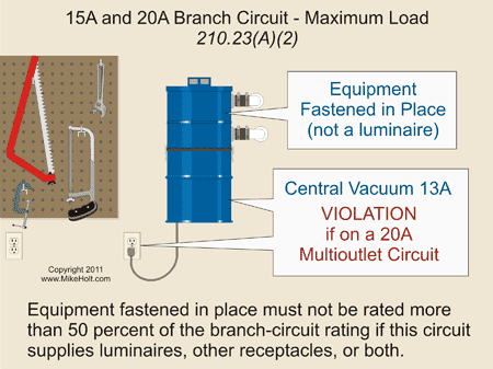

A. An individual branch circuit is permitted to supply any load for which it's rated, but in no case is the load permitted to exceed the branch circuit ampere rating [210.23]. Branch circuits rated 15A or 20A supplying two or more outlets must only supply loads in accordance with 210.23(A), which says that a 15A or 20A branch circuit is permitted to supply lighting, equipment, or any combination of both. Except for temporary installations [590.4(D)], 15A or 20A circuits can be used to supply both lighting and receptacles on the same circuit.
Cord- and plug-connected equipment not fastened in place, such as a drill press or table saw, must not have an ampere rating more than 80% of the branch circuit rating [210.23(A)(1)]. UL and other testing laboratories list portable equipment (such as hair dryers) up to 100% of the circuit rating. The NEC is an installation standard, not a product standard, so it can't prohibit this practice. There really is no way to limit the load to 80% of the branch circuit rating if testing laboratories permit equipment to be listed for 100% of the circuit rating.
Equipment fastened in place (other than luminaires) must not be rated more than 50% of the branch circuit ampere rating if this circuit supplies luminaires, receptacles, or both [210.23(A)(2)], as shown in the Figure above.
