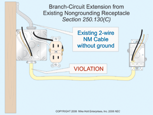

Q. I am doing a remodel on a very old home with 2-wire NM cable and non-grounding type receptacles. We want to add receptacles, but aren't sure how to ground them. What are my options?
A. Let's start by talking about replacing existing receptacles. Where a non-grounding receptacle is replaced with a grounding-type receptacle from an outlet box that doesn't contain an equipment grounding conductor, the grounding contacts of the receptacle must be connected to one of the following [250.130(C)]:
  1. Grounding electrode system [250.50]
  2. (Grounding electrode conductor
  3. (Panelboard equipment grounding terminal
  4. (Service neutral conductor
It's worth noting that a grounding-type receptacle can replace a non-grounding type receptacle, without having the grounding terminal connected to an equipment grounding conductor, if the receptacle is GFCI protected and marked in accordance with 406.3(D)(3).
When adding new receptacles, you can't take an existing 2-wire circuit and extend it to add any new receptacle outlets [250.130(C)], as shown in the Figure. Any new receptacles added to the building will need to be connected to a circuit that includes an equipment grounding conductor, which complies with 250.118.
