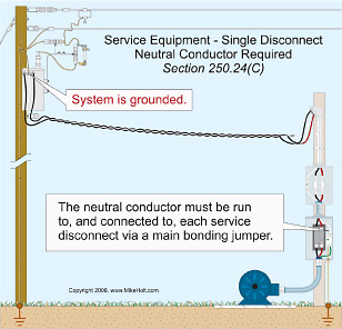

Q. Since the electric utility power meter has the neutral bonded to the enclosure, is it necessary to install a main bonding jumper in the service disconnect?
A. Yes, a service neutral conductor from the electric utility must be routed with the ungrounded conductors and terminate to the service disconnecting means via a main bonding jumper [250.24(B) and 250.28], as shown in the Figure. The service neutral conductor provides the effective ground-fault current path to the power supply to ensure that dangerous voltage from a ground fault will be quickly removed by opening the overcurrent device [250.4(A)(3) and 250.4(A)(5)].
Caution: Dangerous voltage from a ground fault won’t be removed from metal parts, metal piping, and structural steel if the service disconnecting means enclosure isn’t connected to the service neutral conductor. This is because the contact resistance of a grounding electrode to the earth is so great that insufficient fault current returns to the power supply if the earth is the only fault current return path to open the circuit overcurrent device.
