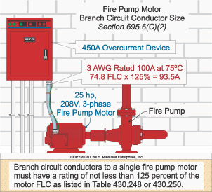

Q. What size conductor is required for a 25-hp, 208V, 3-phase fire pump motor (see Figure)?
A. Size conductors at 125% of the motor's full load current (FLC) as listed in Table 430.250. Per this table, the FLC of a 25-hp motor = 74.8A.
Conductor 5 74.8A × 1.25
Conductor 5 93.5A
A 3 AWG at 75°C is rated 100A
Note: The fire pump motor circuit protective device size must be set to carry the sum of the locked-rotor current of the fire pump motor indefinitely. According to Table 430.251(B), the locked-rotor current of a 25-hp, 208V, 3-phase motor is 404A.

Q. How do I size the circuit protection device for a fire pump motor?
A. The circuit protective device(s) must be selected or set to carry the sum of the locked-rotor current of the fire pump and pressure maintenance pump motor(s) indefinitely — and 100% of the ampere rating of the fire pump's accessory equipment. The requirement to carry the locked-rotor currents indefinitely does not apply to fire pump motor conductors [695.4(B)(1)].
