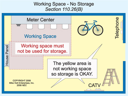

Q. Is there a Code rule that says you cannot store items in the electrical room?
A. No. The electrical room can contain storage items, but the working space required by 110.26 must be clear at all times.
