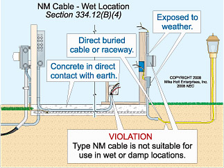

    Q. Can Type NM cable be installed in a raceway in a ground floor slab?
    A. Maybe. Type NM cable is not permitted to be installed in a wet location [334.12(B)(4)] and according to the definition of a “Location, Wet” as contained in Art. 100, “a raceway in concrete slab that is in direct contact with the earth is considered a wet location.” So in this case, the answer is no, you're not permitted to install Type NM cable in the raceway (Figure).
    However, if a plastic vapor barrier is installed between the earth and the concrete slab, then the concrete slab is not in direct contact with the earth and any raceway in a concrete slab is not located in a wet location. Under this condition, Type NM cable is permitted in the raceway.
