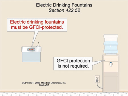

Q. Is GFCI protection required for drinking water fountains in office buildings?
A. Yes. See Sec. 422.52 of the 2008 NEC.
