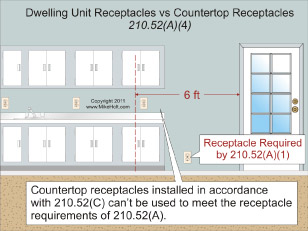

Q. Can receptacles installed above the kitchen counter also be used to meet the 6-ft requirements of 210.52(A)(1)?
A. Not according to newly added Sec. 210.4(A)(4). Counter receptacles required by 210.52(C) can’t be considered for the receptacles required by 210.52(A), as shown in the Figure.
