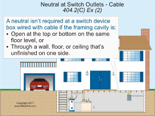

Q. When is the neutral conductor required to be provided at the switch location for lighting loads?
A. Switches controlling line-to-neutral lighting loads must have a neutral provided at the switch location [404.2(C)] unless either of the conditions of the following exception is met.
Exception: The neutral conductor isn’t required at the switch location if:
  1. The conductors for switches enter the device box through a raceway that has sufficient cross-sectional area to accommodate a neutral conductor.
  2. Cable assemblies for switches enter the box through a framing cavity that’s open at the top or bottom on the same floor level, or through a wall, floor, or ceiling that’s unfinished on one side, as shown in the Figure.
Note: The purpose of the neutral conductor is to complete a circuit path for electronic lighting control devices.
