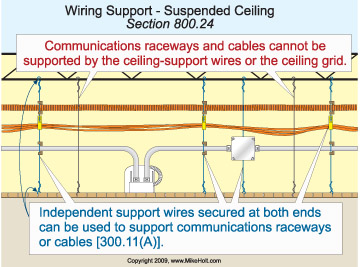

Q. What are the requirements for supporting communications raceways and cables above a suspended ceiling?
A. Communications raceways and communications cable assemblies must be securely fastened in place, and ceiling-support wires or the ceiling grid must not be used to support communications raceways or communications cables [800.24], as shown in the Figure. Raceways and cables are permitted to be supported by independent support wires attached to the suspended ceiling [300.11].
