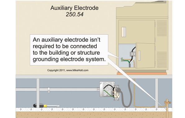

    Q. Can a ground rod alone be used to ground a light pole or other equipment instead of installing an equipment grounding conductor?
    A. No. A ground rod to a light pole or other equipment is considered an auxiliary electrode by the Code and can’t take the place of
    an equipment grounding conductor. Auxiliary electrodes can be connected to the circuit equipment grounding conductor. They’re not required to be bonded to the building or structure grounding electrode system, the grounding conductor to the electrode isn’t required to be sized to 250.66, and their contact resistance to the earth isn’t required to comply with the 25-ohm requirement of 250.53(A)(2) Ex [250.54], as shown in Fig. 1 (click here to see Fig. 1).
    Caution: An auxiliary electrode typically serves no useful purpose, and in some cases it may actually cause equipment failures by providing a path for lightning to travel through electronic equipment.
    The earth must not be used as the effective ground fault current path required by 250.4(A)(5).
    Danger: Because the contact resistance of an electrode to the earth is so great, very little fault current returns to the power supply if the earth is the only fault current return path. What’s the result? The circuit overcurrent device won’t open and clear the ground fault, and all metal parts associated with the electrical installation, metal piping, and structural building steel will become and remain energized.
