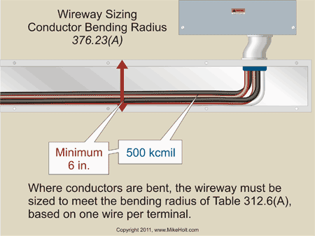

Q. What is the minimum wire bending space requirement for conductors that enter a panel from a metal wireway?
A. If conductors are bent within a metal wireway, the wireway must be sized to meet the bending radius requirements contained in Table 312.6(A), based on one wire per terminal [376.23(A)].
