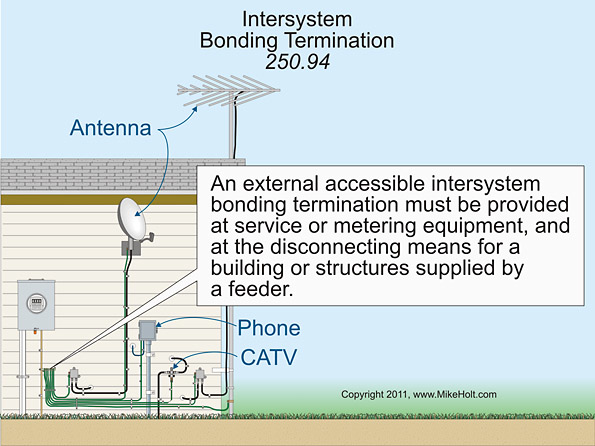

Q. What is the Code requirement for an intersystem bonding termination, and what is to connect to it?
A. An external accessible intersystem bonding termination for the connection of communications systems bonding conductors must be provided at service equipment or metering equipment enclosure and disconnecting means for buildings or structures supplied by a feeder [250.94], as shown in the Figure. The intersystem bonding termination must:
The intersystem bonding termination shall comply with six specific requirements.
  1. Be accessible for connection and inspection.
  2. Consist of a set of terminals with the capacity for connection of not less than three intersystem bonding conductors.
  3. Not interfere with opening the enclosure for a service, building/structure disconnecting means, or metering equipment.
  4. Be securely mounted and electrically connected to service equipment, the meter enclosure, or exposed nonflexible metallic service raceway, or be mounted at one of these enclosures and be connected to the enclosure or grounding electrode conductor with a minimum 6 AWG copper conductor.
  5. Be securely mounted to the building/structure disconnecting means, or be mounted at the disconnecting means and be connected to the metallic enclosure or grounding electrode conductor with a minimum 6 AWG copper conductor.
  6. The terminals must be listed as grounding and bonding equipment.
According to Art. 100, an intersystem bonding termination is a device that provides a means to connect communications systems grounding and bonding conductors to the building grounding electrode system.
Exception: At existing buildings or structures, an external accessible means for bonding communications systems together can be by the use of a:
  1. Nonflexible metallic raceway,
  2. Grounding electrode conductor, or
  3. Connection approved by the authority having jurisdiction (AHJ).
Informational Note 2: Communications systems must be bonded to the intersystem bonding termination in accordance with the following Code requirements:
  • Antennas/satellite dishes [810.15 and 810.21]
  • CATV [820.100]
  • Telephone circuits [800.100]
All external communications systems must be connected to the intersystem bonding termination to minimize the damage to them from induced potential (voltage) differences between the systems from a lightning event.
